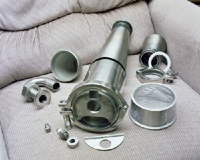

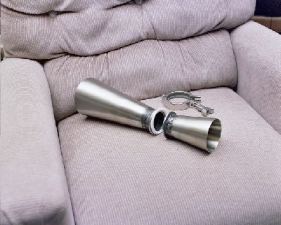

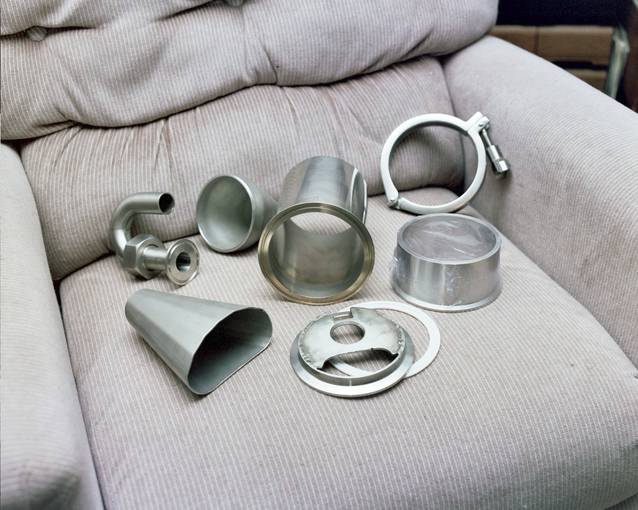

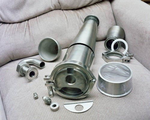

Here are the parts for the prototype. The maximum diameter tube (combustion chamber) is 4 inches OD. This is mostly 316SS Sanitary Tubing, often called 'dairy tubing' since moving milk around is one of its major uses. It is extremely accurate in size and roundness; smaller sizes are .062 inch wall thickness; larger sizes .065 inch. It is wonderful stuff to see and handle. It is also not cheap.
The recycling cone was professionally fabricated, but I didn't have to pay for it because they made it to fit my drawing (double size) instead of making it to the dimensions that were clearly shown on the drawing. An embarrassment for sure.
Other than the use of the flanges and heavy clamps to hold it together (oh, and the absence of the outer cooling shell), this is exactly the prototype as shown in the first drawing of my SBIR Proposal.

Gorgeous parts by the way...

Yes, the sanitary tubing is beautifully finished, highly accurate material. Even the eccentric cone edges were a virtually perfect fit to the tubes and fittings. Although the material is inherently expensive, the nice part is that cutting fees (at least where I ordered this stuff) were incredibly reasonable -- which means you don't have to buy any wasted stock! You just have to know exactly what you want. As far as I know, this tubing is available in a very limited set of sizes (all OD, like all "tubing"): 3/4-inch, 1-inch, 1.5-inch, 2-inch, 2.5-inch, 3-inch and 4-inch tubing. Lengths up to twenty feet, if I remember correctly.Ghrey wrote:Gorgeous parts by the way...
The pieces are produced such that even custom cutoff ends are perfectly smooth (as if cut off in some kind of big lathe) and they fit together EXACTLY for butt welding. The material is available in Type 304 SS (brush finished) and Type 316 SS (high polish inside and out) -- the two materials can be welded to each other with Type 308 filler rod or wire, if you want to mix them for some reason.
The flanges and clamps shown are what are usually known as Tri-Clover, but that's just a brand name, really. The white gasket rings are TFE based material (NOT guaranteed for really high temps -- I finally decided to use glass fibre matt for gaskets). As you can see, the connection for the removable U-bend is a different type threaded fitting. There are several connection methods available, but they all involve butt welding some kind of fitting onto a tube end.
All you ever wanted to know about Sanitary Tubing. Ha.

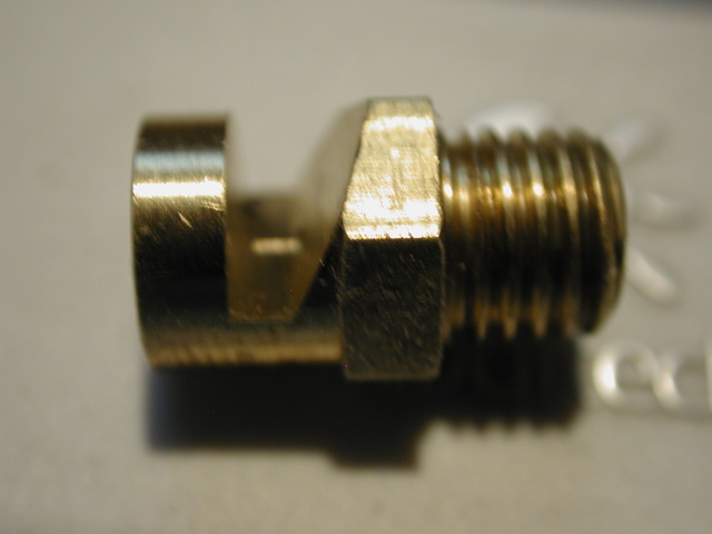

Ghrey
- Posts: 286
- Joined: Fri Feb 15, 2008 8:41 am
- Location: Studio City, California
Re: Now It Can Be Told ... Cyclodyne Revealed
Sprinkler head, fuel sprayer.
For scale the threads are 5/16-24
ANY NC shop can make them fast and easy. Just adjust the center bore to your delivery pressure/flow requirements. This one is made to CalTrans specks. for irrigation water.
Note: the higher the pressure the finer the mist.
