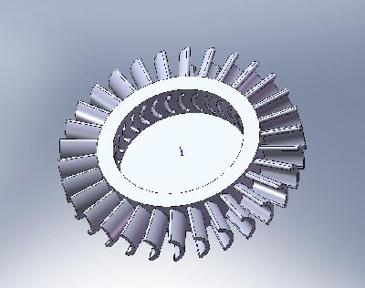

redneck wrote:would it be possiable to make good turbine blades by cutting a pipe of sufficient metal in thirds long ways, and depending on the angle of blade you need, get a pipe of larger or smaller radius? To cut it in thirds is just an example number, it would depend on how large a blade you are looking for. after the blades are cut, weld them to a pipe with a bearing on the inside monted on a center shaft? just trying to figure a way to make turbine blades without a lathe or a turbo.... any input????
I've always been fascinated by the idea, and was just playing with it this week. This one has tube sections, but what's not shown well is that there's a center section that goes into the ID of the carrier for welding inside (easier access).
Another was one that we could make in a manual mill with an indexer mounted to a rotary table (or of course an indexer in an NC). A tapered endmill is used to thin the blades.

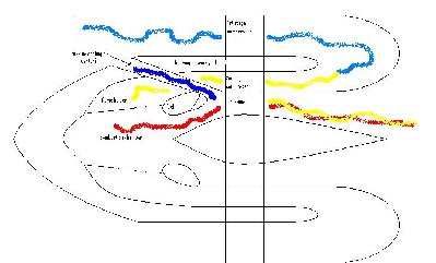

are there any free pages that i can use to put up a design? I like all the solid work pics but as i have to use a library pc, i caint get that stuff, any help cause microsoft paint is a pain in the rear!!!!!

lets see if this worked....
hooowee that was loud! do it again!
redneck
Posts: 94
Joined: Tue Dec 26, 2006 10:32 am
Re: turbine blade source
Post by redneck »
redneck
Posts: 94
Post by redneck »
sorry for the 3 posts.... not very computer savy... so it took a bit to get my pic online... the above pic is the design for the GT i would like to propose and use cut pipes for. what do yall think????? and maybe somebody with a better program than paint could make it better???? I tried downloading a program and i couldnt at the library.... tell me what yall think???
Post by Mike Everman »
Yeah, man. That's the idea. Someone has to come up with a single wheel turbojet. That's a great idea, of course! I've got a different take on it. Maybe I'll model it up tonight.
Posts: 5022
Joined: Fri Oct 31, 2003 7:25 am
Location: santa barbara, CA
Contact:
The devil is in the details, though. If you don't have the math right, it will certainly fail. That's not just doom and gloom, it's a fact. I'm sure not up to it.
