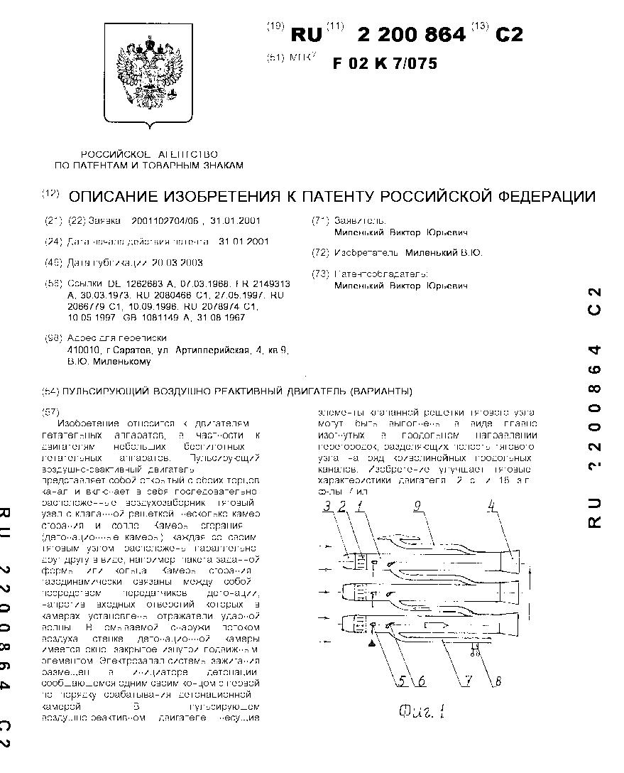

Daisy-chained valveless pulsejets! Come to think of it, there may be valves, I can't read it, it's like those Russians have a different word for everything!

It is the patent from the private person. Its home address is specified only. I shall try to contact the author (m.b.).Mike Everman wrote:Thank you very much! Bruno can start a "I hate PDF thread" somewhere, so how about this drawing? Where's our Russian member when you need him? I'd love to know what some of it says.
This patent describes a pulsejet engine with chain of chambers of combustion (detonation) which are connected gas-dynamic. In figure chambers of combustion (detonation chambers) and small tubules of transfer of a detonation are shown _ONLY_.
These engines (most likely) are declared as detonation (PDE). At least their way gas-dynamic communications - detonation tubes. This engine is offered for flying devices.
I DO NOT THINK that it is the serious patent. It simply a label (mark, sign). A designation of any priority.
The most sad - Russian patents are _less_ accessible to viewing on the Internet than American patents :(

Ah, thank you for the content, Dmitry! And yes, sadly there is very little accessable to me from Russia, especially in the IPC code that is "pulsed combustion", but I'm still looking. I have a pretty good international patent service, and will keep an eye on it.dmitry wrote:The most sad - Russian patents are _less_ accessible to viewing on the Internet than American patents :(
Michael and Dimitry,
Thanks for the input. An interesting layout even though I failed to understand it completely. It would seem to transmit a shockwave for timing purposes only. Maybe it could work if you wanted to run an entire daisy chain of pulsejets.
