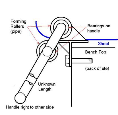

Another tool to my colection comming up too!
Sheet forming slip roller.
I made a rough one that i used for my last engine, and it worked great!
It was simply angle and pipe welded together with some legs clamped to my ute!
This, i think from my first model, will be the ideal.
Any suggestions?
