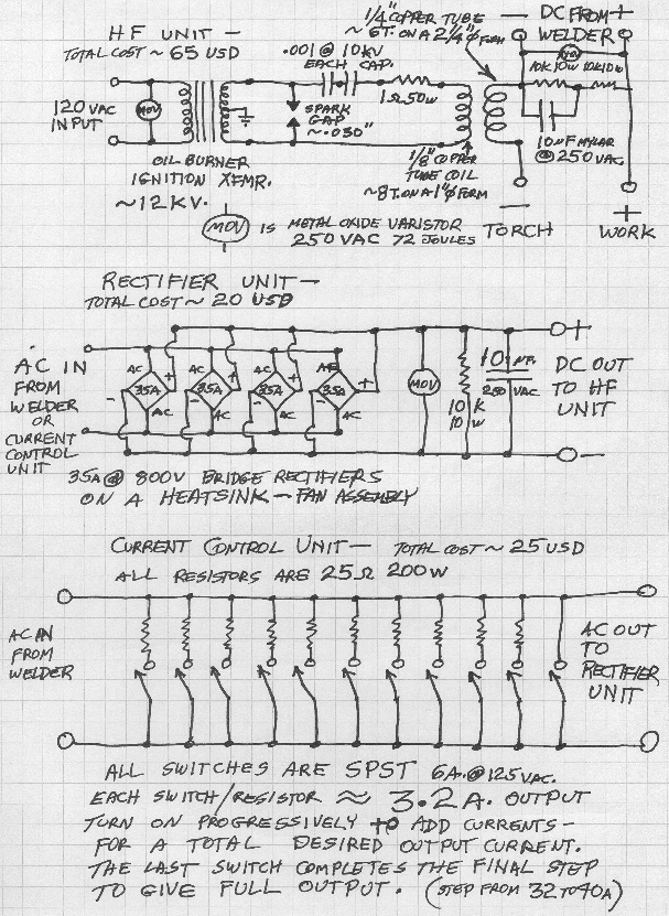

TIG welder
The following diagrams show the essential circuitry that I used to build My homebrew TIG welder.
All electronic parts are available from www.hosfelt.com
The ignition transformer is P/N 2e507 from http://www.grainger.com/Grainger/wwg/start.shtml
Please note that the resistors are made from lower wattage units that are placed in series/parallel arrays to achieve the power handling capacity.

Al, Thanks for the diagrams. I'm looking to try to adapt your HF system to my welder. I see why yours works where my first idea didn't. It has the HF system inducing a current via a transformer of sorts in series whereas mine just had the HF system in parallel which just shorted through the power source. There is one part I don't quite understand, however. That is the coil arrangement between the spark gap circuit and the welder circuit. I don't quite understand your notation. It looks like 6 turns of wire around a 1/4" copper pipe but what does 2 1/4" phi form mean? What is the physical relationship between the two coils? Are they parallel to one another, concentric, or what? What gauge wire did you use here? Also, what is your initial power source; an AC welder?
Thanks again.

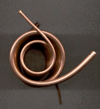

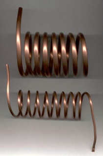

Coils
Hi,
The coils are mounted concetrically ( the small inside the large )
The inner coil is made from 1/8" copper tube wound around a 1 1/4"
form; the outer coil is made from 1/4" copper tube wound around a
2 1/4" form. The inner coil can be made from heavy copper wire
#8 or #10. I used tube since I had it in stock.
See attachments.
Al Belli
See attachments.
