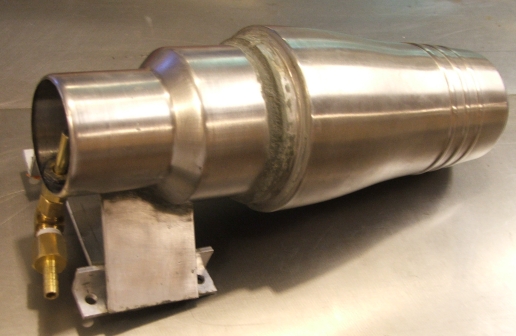

I have done a lot more over the weekend
I installed the fuel tube and I glued on the mounts as well and I am almost done!
I have completly used up my supply of epoxy, but all I have to do now is put the spark plug in and then I will be done!

- Almost done!
- DSCF0782-downsized.jpg (116.81 KiB) Viewed 21765 times
- Fuel tube detail
- DSCF0784-downsized.jpg (136.2 KiB) Viewed 21769 times
- Inside from the back
- DSCF0786-downsized.jpg (132.02 KiB) Viewed 21764 times
- My slightly messy workspace
- DSCF0792-downsized.jpg (212.35 KiB) Viewed 21770 times

Bob, I have to hand it to you: It's really looking awfully good!
Since you're interested in a flying model, I'll take the liberty to describe how I was going to accomplish that:
I have an old Olson-Rice .60 cu.in. engine stripped down for glowplug running (i.e. all the ignition stuff is long gone). I was going to put an impeller from a medium-power leaf blower on the front end of this (with a starter pulley), and then have a carved shroud that would surround the impeller with a volute at the front end, routing all the air through and around the cooling fins and out the back where it would taper in slightly to "nozzle" the outflow (exhaust from the engine would be piped outboard so oil wouldn't end up in the forced air flow). Then I was going to mount Maggie a little distance behind this nozzled outlet.
The idea was that the forced air would be enough to get Maggie started before launch and keep her running until the plane was up to speed. Then, the piston mill would run out of fuel, leaving Maggie to carry the whole propulsion load. So, it would be a motorjet to ramjet transition design. This should work because the nozzled cowl would pull air inward from the two sides and blend it with what still gets through around the "dead" engine, due to the ample space in front of Maggie's inlet face. Some experimentation required (maybe some draggy baffles, too).
Of course, you may come up with a better scheme. I even thought of using water rocket boosters for the initial acceleration to speed.
Good luck!

Thanks Larry,
I like your idea, I wasnt really shure how I was going accelerate it in the begining. I think it would be a little bit better to have the motor located inside the main shell of the aircraft and have a chain or a belt going to the propeller as this would produce less drag. It would be great to put on a model aircraft, but I have to get it to run first! By the way, would an argumentor work for my shopvac to improve the effective air outlet size?
Construction is temporaraly on hold because I wasnt able to find a good sparkplug for this. What do you recomend for a sparkplug?

Look for a CM-6 or other 10mm plug. A good hardware store will have M10x1.0 hex nuts to fit it - maybe even stainless. An augmentor for your shop vac will increase the breadth - BUT you will have a lot lower speed airstream. No free lunch from augmentors - ha! Remember that the pressure you develop in your diffuser (and therefore, in the chamber) will depend on the speed of what goes in the inlet.
For testing, you don't need a sparkplug. A sparkler up the tailpipe[1], burning rag, anything to get a flame. Once it's going, you shouldn't need a plug anyway.

Thanks for the tip Larry,
I think I am going to go with the sparkplug just to ensure that the flame front is completly behind the flameholder. A sparkler works fine for an engine where the fuel is injected behind the flemeholder, but not for this engine because of where the fuel is injected.

Hey bob, my injector was a good several inches in front of the the flame holder too, and the sparkler just randomly half way down the engine. A sparkler is a much more forgiving way of igniting your ramjet, simply, its about 2000 degrees, and fires hot shards of metal everywhere almost guaranteeing ignition. You will find a "sweet spot" with the the sparkler that will allow you to better approximate your sparkplug position.
With the injector infront of the flameholder, its mixing all the way down and through the flameholder, when its through the flame holder, its well mixed and ready to burn, you would never really light a ramjet in front of the flameholder, I don't think it would actually ever light doing that? If you just want to see how it runs, there no shame in a sparkler at all.

With the injection system infront of the flame holder you are going to get flames infront of the flame holder no matter what you do. Though the engine doesnt have a true diffuser section where the flow would slow down for it to burn well, its probably going to have quite a bit of flame infront.
Also with the injector pointing to the top wall most of the fuel is going to go upwards. and at low blower speed it could even come out the front of the engine.

Actully, Eric the fuel injector is not pointing twards the top but it has the top blocked off and a series of five holes drilled in it, all pointing twards the rear of the engine. I think I am going to go with a sparkler after all, just because it keeps me from drilling any more holes(I might mess up eventully) and I also dont need a high voltage coil to get the plug running! this is a plus because I was going to just use an old Piezo grill ignitor I got and that doesent always throw a spark and almost never sets things on fire.
