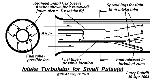

However, I'm going to hold off a bit, and here's why: The first shot I'll try at turbulating the flow will be to create turbulence upstream of the fuel entrance. I'll use some kind of little 'Christmas tree' gimmick slid down into the pipe. Even though I'll try to make this fairly 'low profile', it will obviously introduce some flow impedence of its own, and who knows how close it might come to being about right? If that doesn't seem to produce desirable results, I'll go to more extreme measures, i.e. a bluff body or two in the bottom of the chamber where the forward flow is, and then apply your taper to the unhindered stack.
Do I understand that you want the taper closing toward the top of the stack [the inlet], a la Lockwood intake? It seems that way, since you warned earlier about leaving a flare there. I know a flared inlet would have been a good idea in the first place, but wasn't sure of a good way to get it.
What do you think of the plan of inducing turbulence before fuel induction? As I see it, my turbulator would run right down to the station where the fuel enters. It could even go beyond, of course, if it doesn't seem too draggy.

For a given level of fuel input, getting the EXACT airflow needed is quite critical. It is extremely easy to overblow this engine with starting air. Using the leaf blower was very difficult -- it turned out that the shop vac was much easier to handle, but even with that it was difficult to angle the nozzle just right to get just the trickle of air needed. My earlier guestimates of starting air requirement were way too high, at least with the turbulator anywhere in the intake.
The location of the turbulator makes a big difference in the kind of combustion action you get. Basically, it seems to work better the deeper into the intake you slide it. At first, with it high in the stack [by which I mean, fairly near the inlet] it had a barely noticeable effect; when you get it down in the middle of the path, its action seems much better [that is actually about the relationship to the fuel outlet I had shown in my original drawing in my thread on that subject, re-shown below]. Farther down might even be better, so that the fuel is introduced in the laminar flow and then mixed up later as it all gets vortexed together behind the blades.
I found that it was possible to observe the combustion in the chamber by looking right 'down the chute' through the intake stack from a safe distance above and behind. In the common situation of a too-rich mixture, the yellow flame is firing right beneath the fuel port, inside the stack! When air is removed and brought back in, unburned fuel gas has accumulated for a split second and generates a bang that comes out both the exhaust and intake. This can be blue, or very rich and bright yellow with a very loud report.
In the odd moment when you get the air just right for a while, you can see the blue flame racing past the angled cutoff face at the bottom of the stack, just as it should! If you can hold this a little while, you start to get some heating of the tailpipe; the galvanizing is still there, but it now looks like grey primer. At any rate, it was fun to see good combustion moving right past that port, with nary a feather running up the dark walls of the stack!
That's about all I was able to find out. In such cool conditions, it's hard to keep the propane or MAPP flowing very well for very long. I got lots of good bangs and roars, even some higher pitched brief squeals. I did get myself a 20 lb tank of propane Saturday and I now have my old high flow volume Victor regulator set up with the proper stem to connect it, plus the gauge and needle valve needed. Next time, I should be able to run a lot longer! I don't know if a large MAPP tank uses the exact same left-hand threaded stem or not. It is somewhat easier to get good noises out of MAPP gas, but the ambient temperature may have something to do with that.
- The intake turbulator, discussed in detail in an earlier thread on this forum - drawing Copyright 2004 Larry Cottrill
- Intake_turbulator.gif (5.45 KiB) Viewed 17244 times

What I was able to do in both runs is get full grease Dynajet roar operation, and some areas of red hot metal within less than a minute after leaning out the mixture. The red hot zones are the flat sides of the chamber, the first few inches of exhaust pipe and the very bottom half inch or so of the intake tube, down inside the chamber where the exhaust slips around it to get to the pipe. Looking down in there, it is something to see -- the red hot rim with thick blue fire streaming past the hole. It's still a thrill for me just to watch it do that! However, I still only get the best running power with the nozzle of the blower right down on the intake, and then you can't see it in action any more 'from the inside out', of course.
If this thing would ever take off and sustain, I guarantee you it would NOT resemble your average 'hamster breathing through a straw'. But, aye, there's the rub. Yes, I can get a horrendous roar -- from under my sound muffs, it sounds just like the Dynajet: a hard, sharp, nasty waveshape. Yes, I can run it like that till metal starts to glow. Yes, I even get a little frost on the propane tank. But try as I might, I cannot find a fuel setting that will let it keep running when I pull the air away. If I back the blower off slowly, it either quits [if set for rich running] or slowly fades into weaker pulsing, rapidly devolving into dull howling, and then 'blowtorch' mode operation [if set lean]. No matter what 'in between' setting I try, it won't catch and go on its own. Perhaps my technique with the blower is poor. Maybe the intake still just isn't right. Who knows?
I now have some fairly good video of it 'running' like that, and should have a couple of still shots to post before the end of the week.
What it appears to boil down to is this: It simply does not seem to develop a really good suction wave on its own.
