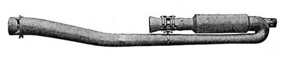

Larry,
You might try your program on SNECMA Ecrevisse.
Namely, it appears that one of the reasons why the Ecrevisse was not bent into the U-shape, like the Lockwood, but rather in a kind of J (i.e. immediately after the combustion chamber), was precisely to get the waves emanating from the intake phase well with those coming out of the exhaust.
It would be interesting to see what they got.
Here's a picture.
Here's a picture.

Cool. However, I'd need to know the actual dimensions [well, just one - the distance from the intake to the tail] and the typical operating frequency. Then, I would assume a particular speed of sound under average sea-level conditions to get a reasonable shot at the primary wavelength.Bruno Ogorelec wrote:Larry,
Here's a picture.
The intake and exhaust diameters are so close to each other that I wouldn't need to bother with the end corrections for the acoustic points. It would be an interesting exercise, since they claim to have gone out of their way to achieve that kind of geometry! Such an engine would have a maximum intensity in a fairly broad swath directly behind it, sort of like the front end noise in my drawing.
If you're saying that their claim was that the intake and exhaust were precisely ONE wavelength apart, of course, I could go ahead and draw it up knowing nothing more, just assuming that they were able to get it right for sea-level air of "normal" temperature. [They would not achieve such grand acoustic performance under all possible conditions, of course - the dimensions of the engine are fixed, the wavelength of a given frequency in variable condition air is not.]

Ah, you're right. In the discussion immediately above, I conveniently forgot about the phasing part! Note that I had this covered in my original discussion with my drawing.Ben wrote:There's also the issue of timing. It seems that you are assuming that the pulse comes out of both the intake and exhaust at the exact same moment, which seems unlikely for some engine geometries.
So, Bruno, I guess what you're saying is just that their geometry is supposed to get the crest of the intake wave to cross the tailpipe exit just as its crest emerges; we still need some value for the wavelength in normal air [based on the operating frequency, and the physical dimension separating the two starting points. An alternate method would be if they actually state somewhere what the phase difference is supposed to be between the intake and exhaust ports.
Another clarification: Note that the emerging crests from the two points need not [necessarily] be from the same explosion event! The phase difference in outside air is NOT identical to the phase difference of the internal pressure wave in the engine [this is shown in my drawing, above, where the cold air whole wave is illustrated, rightly or wrongly, as MUCH shorter than 1/4 wave in the engine!].
Ben, thanks for the correction!
Re: A new propane line, Larry you better sit down for this :
Larry, unfortunately, I do not have the necessary data on the Ecrevisse, but hope they will surface in the translations.

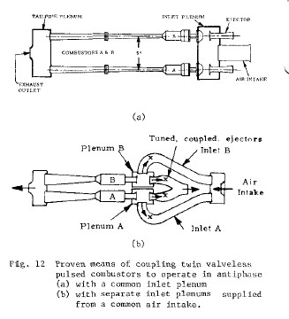

Meanwhile, I have found the sketches of Kentfield's successful efforts to couple two valveless pulsejets. (Much trickier than with valved engines.)
I think his approach was not the best, but then, I am convinced of so many other unusual things....

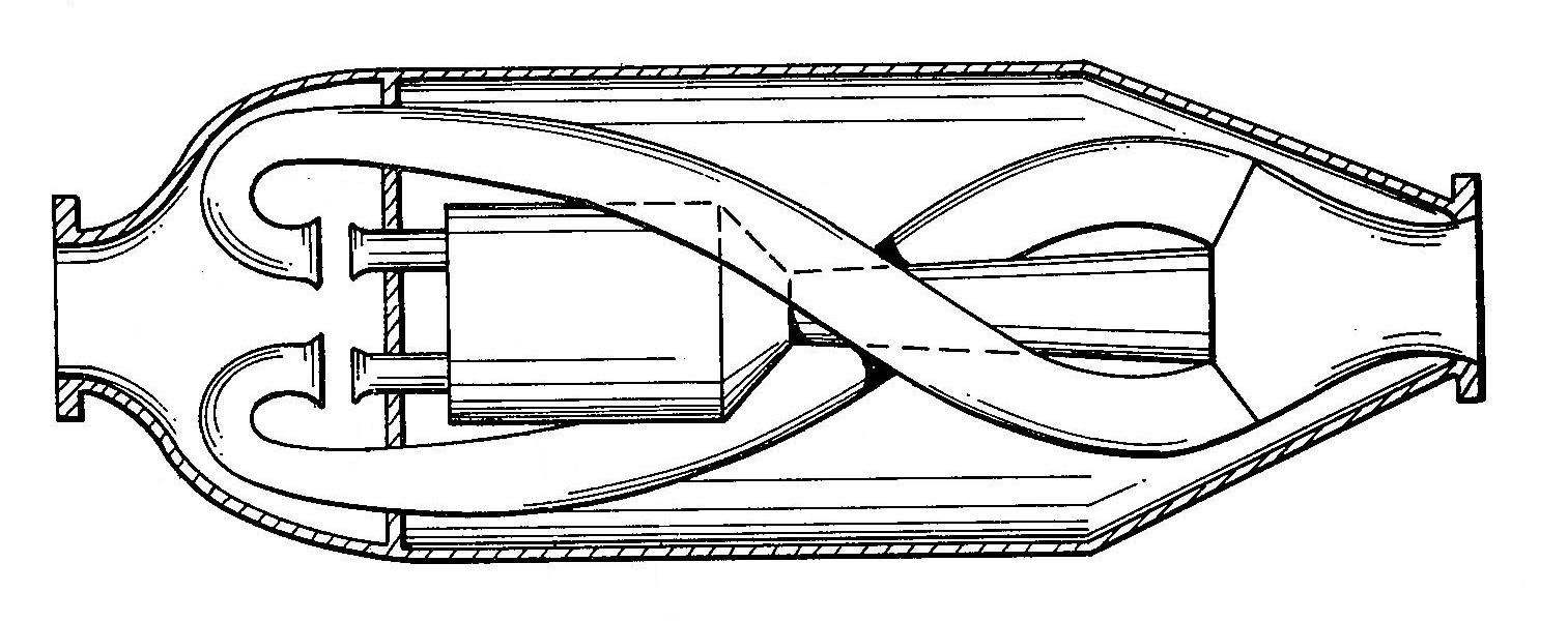

Ah, here's Kentfield's Snaking Synchro Recuperator. Enjoy.

That coil thrust recouperator looks like soo much fun to build! Just makes me want to jump up and try radically bending thin walled pipe without any kinks.

Bruno, the coupled Kentfield looks very nice but it's no weekend project! And don't be trying to sneak any optical illusion designs in either that might cause seizures in the uninitiated. Might be funny though to have a drawing of something like the 3-prong illusion drawn up as a puslejet. Would make for a wonderful logo, and how fitting because pulsejets can be so illusory.

Interesting! You know, I did try something of a sort a long ago. I was looking at the Klein bottle as a possible interesting layout for a pulsejet and eventually came up with the Unicone.Mark wrote:Bruno, the coupled Kentfield looks very nice but it's no weekend project! And don't be trying to sneak any optical illusion designs in either that might cause seizures in the uninitiated. Might be funny though to have a drawing of something like the 3-prong illusion drawn up as a puslejet. Would make for a wonderful logo, and how fitting because pulsejets can be so illusory.
http://www.scientificpsychic.com/graphics/
Maybe it's a good thing I didn't stay with the Klein bottle. Here's what one explanation I have found says about it: "The Klein bottle is an example of a two-dimensional differentiable manifold." There's a further explanation, too: "A differentiable manifold is a second countable Hausdorff topological space that has been endowed with a differentiable structure."
Once you get that, it is very easy to apply the Hinote Criteria onto it and, voila! you have a single-surface pulsejet.
