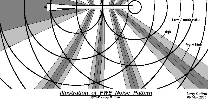

Here's a crude illustration of how the noise might lay out around a running FWE engine. In this drawing, the wavelength in air is assumed to be a small fraction of the effective wavelength inside the engine. At this particular moment in time, a whole wavelength has been propagated from the corrected acoustic point behind the intake flare, and the wave crest from the tailpipe acoustic point is assumed to be lagging by 75%, which is why the last crest to emerge is such a small circle around that point.
This is an illustration only; the actual layout of intense and rarified zones will depend on the actual wavelength of the sound in cold air and the phase difference between the two points. If we were to show a higher frequency [harmonic], the pattern would be MUCH more complex, though the principle would be the same.
In the drawing, the most heavily reinforced sound is shown in dark gray, heavily reinforced is in light gray, and less reinforced sound is the white zone. The borders are arbitrarily selected by me.
It just happens that my illustration shows one heavily reinforced zone that roughly corresponds to Eric's observed 45-degree "line". That was purely accidental. An accurate layout could only be drawn if the frequency and air temps were accurately known.
An illustration of noise pattern surrrounding a running valveless pulsejet. Drawing Copyright 2005 Larry Cottrill

Post by larry cottrill »
Mark wrote:Eric, that is one heck of an interesting bar stool adaption.
Yes - it's nice to see someone really taking the ever-crucial tailpipe flare seriously.

Great illustration, Larry. Hmmm. Ahhhh. Hmmmm, etc. Very nice.
