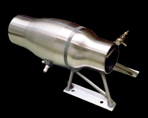

Sorry I haven't looked in here much lately -- I just now noticed your posts. Maggie is still untested, BUT the horse barn is finished and my day job is FINALLY easing up a bit, so it looks like I should be able to start work on a decent thrust-measuring test stand for maggie.
I think I have decided to follow Ben's [and your] example and try using propane for the initial testing of Maggie, for one reason: with vapor as a fuel, I can test my ability as a jet engine designer, instead of my ability as a carburetor designer. Ha!
I have revised the Maggie Muggs site quite a bit in just the last few days. Here is a humorous gimmick to introduce your non-jet-interested friends to the site: http://bz9.com/guess [go ahead and try each of the four captions - this is supposed to be hysterically funny, naturally].

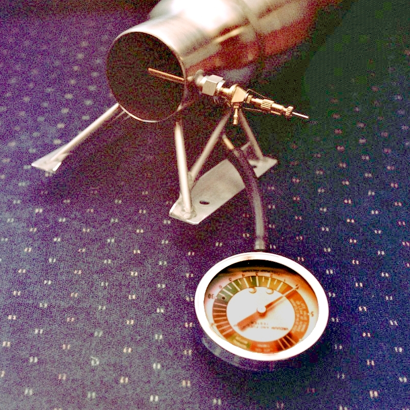

I have finally obtained what should be a suitable air supply for testing Maggie: the mighty Black & Decker Leaf Hog blower/vac. Maximum velocity is 215 MPH, which I hope will be far more than adequate. Naturally, I can't remember the CFM now, since I didn't write it down, but it seems enough for both combustion and cooling for an engine of Maggie's size. Current load is 12A at 120VAC, for a power consumption of 1440 watts. The noise is horrendous.
It is interesting to crudely evaluate this machine by blowing it across the grass, since I have a lot of experience seeing the Dynajet perform this very function. The Dynajet wins hands down, probably by a multiple of five or six! While such a judgment is highly subjective, I find it amusing that the venerable Djet, basically unchanged in design since the year I was born, moves air far better than a modern 1400 watt centrifugal fan.
Using the automotive pressure/suction gauge for preliminary testing, the maximum velocity pressure obtained at the nozzle outlet appeared to be right at 0.5 PSIG, not nearly as high as I would have thought [this was air at 70 degF, but not really 'standard air', as here in Iowa we are about 1000 ft above Mean Sea Level]. At this presumed 215 MPH velocity, it was relatively easy to push Maggie, hand-held, right up to the nozze outlet. I would estimate the maximum total drag at maybe half a pound [of course, my hand holding Maggie was part of this]. I halfway expected some kind of howl from Maggie [because of all the little holes], but all I heard was a kind of white noise roar increasing in intensity as I brought her closer in.
Now, here's the first indication of a possible design inadequacy - see what you think:
Putting the gauge on Maggie's pressure tap [the tube coming out of the bottom of the diffuser], I DO get a positive static pressure rise, but only about 0.2 to 0.25 PSIG max!!! Friends, we might as well face it -- that is not much pressure to work with. Of course, this is static pressure gain only [if you assume the design of my pressure tap is sensible] and there seems to be plenty of air getting through Maggie, so the velocity pressure component getting through the holes could be more on the order of the 0.5 PSIG measured out in front. Still, the total [static gain + velocity pressure] has to approximate the maximum gauge pressure we can maintain by combustion in the chamber. [All gauge measurements mentioned here are approximate -- it is impossible to read such small deflections on the gauge with any real precision.]
Conclusion: Sadly, it appears that the net thrust of Maggie Muggs is going to be measured in ounces, not pounds, even at a speed that is still reasonably hard to obtain. [Possibly, could THIS be the reason nobody's out there hawking low-speed ramjets?]
Now, kind reader, before you click out in total disgust, remember that Maggie's total engine weight is just 10.5 ounces. So, perhaps the problem in using Maggie as a flight engine will not be so much in net T/W ratio as in the bulk and drag of such an engine in relation to a small model that can be reasonably powered. And, of course, we might have to go to the Rocket Forum to get a launch system for our model! [Recall that what I was hoping for was an engine that could take over after a propeller-driven takeoff and acceleration to reasonable speed. A small model is not going to handle this kind of drag loading to get up to speed.]
I will know more when I get the test stand built. I'm going to make sure that I set it up to measure both total engine drag and net thrust [I can't make it do both at once, of course, but I can have it measure drag in a dry run setup for a given air setting, then fire the engine to get the net thrust]. It also looks like I'll need a force multiplier lever system to get accurate measurements, but that shouldn't be hard to rig.

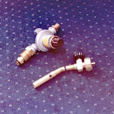

Initial testing will be with propane, and I could also try MAPP gas, which is more expensive but burns hotter and faster [i.e. more rapid expansion]. Here are the beginnings of a propane fuel feed -- the regulator is adjustable over a wide range of supply pressures, and you can see where the torch head was cut off to provide a valve with the proper fitting for the small [hand torch size] propane or MAPP gas cylinders:
http://www.cottrillcyclodyne.com/2004-0 ... _small.jpg
The big cylinger stem at the left end of the regulator will come off, and the valve shown will be mounted in its place. This will provide an easily adjustable and well-regulated supply for experimentation.

Your reference to the aircraft pitot tube reminds me of how silly it was of me to expect a reasonable gauge pressure from the leaf blower airstream -- the fact is, a person blowing into an aircraft pitot tube can instantly ruin the air speed indicator [the instrument mounted in the panel], forcing it back to the shop for repair and re-certification! That should give us a clue as to the kind of pressure gain from velocity alone that we're talking about here!
For my thrust measuring setup, here's the current plan [since I need to multiply the force by a factor for accurate measurement anyway]: The pullrod hooked to the force gauge will pass THROUGH one lever to get to the other, where it will be anchored at the proper moment arm from the fulcrum point. The lever perforated by the rod will reverse the direction of pull [i.e. the fulcrum will be between the two lever ends], and a collar will be positioned on the rod so it contacts when the carriage moves rearward [the 'drag' direction]. So, when the carriage moves back, lever no. 1 pulls on the gauge thru the rod, measuring drag; when it moves forward, contact with the stop collar is lost, and lever no. 2 pulls on the gauge via the rod, measuring thrust. Seems like it ought to work.
The carriage will travel along two channels on glorified roller-skate wheels -- the emphasis will be on freedom of movement rather than precision tracking. The carriage will hold the force gauge and the diffuser pressure gauge [although now that I know better, I might replace that with a simple water manometer].
I'll try to post a picture of Maggie with the gauge attached. Not a very good shot, due to glare on the gauge face.

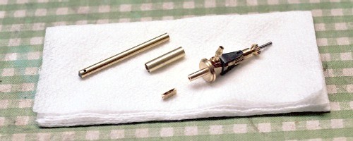

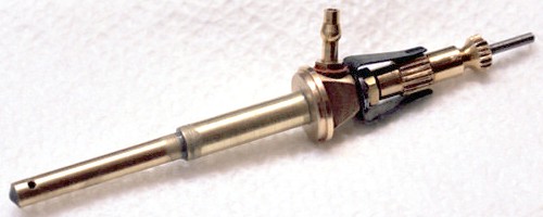

Mark, that's a Super Tigre needle valve, modified by cutting off the fancy machined stub at the 'interior' end. See the Maggie Muggs site at http://bz9.com/Maggie [the 'short link'] -- click on one of the links to Page 2 and scroll down a bit.
[Well, OK, I'll post the pics here too. Note the little cutoff section in the 'parts' photo -- it is discarded.]

Stephen -Stephen H wrote:wow.. that is nice... u make that ?... impressive
Man, it won't go if it ain't good ;-)
Yes, I "made that", but only by buying a Super Tigre needle valve assembly for $18US and hacking the little end off with the jeweler's saw, then gluing on a couple pieces of brass model airplane tubing [with J-B Weld, naturally!] and drilling the hole through. Come to think of it, I also "ported out" the inlet and the main bore with a no. 50 drill to maximize flow. All warranties definitely voided on that one!
That $18 assembly is the single most expensive part I bought to build Maggie Muggs, and the whole engine cost only 50 bucks or so. By contrast, my new High Velocity Laboratory Air Mover [aka Black & Decker Leaf Hog] for testing it cost me $61.50 at Wal-Mart.
