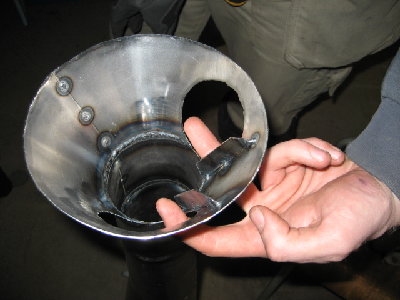

We started building the engine today. Every part is cut out and trimmed to size, a GRIM-style roller is made and bolted onto the work bench and three cones are rolled successfully without any problems. A couple of hours more and the cones are ready for welding, great fun!

The cones are rolled now and the intakes are welded so we can flare them tomorrow. I eagerly await M´s illustration of the engine mod so I can start welding the engine together.

Here are two not-to-scale dimensioned sketches of the starting fences that I want to include
in all Thunderchine builds going forward. The objective is simple: reduce cross-flow between
the opposing intakes during startup. Without the fences, starting air injected down one inlet
has a tendency to "jump the gap" between induction ports on the transition cone then escape
the other inlet. This wastes fuel and prolongs the startup process, particularly for cold metal.
Each fence is a simple 70x14 mm strip* of steel with clipped edges (eg., 45 deg, root to tip),
tack welded inside as shown. No need for exact placement, but preserve left-right symmetry.
(click to enlarge) (click to enlarge) Please note the spark plug mount is shifted forward close to the combustor-transition join.
Questions? You know where to find me!
Cheers,
M.
*If the meaning of strip is unclear: the fences are of thin steel sheet... 70 mm long x 14 mm high. Sorry!
Cheers,
M.
