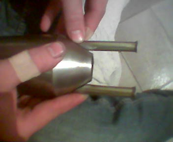

Nice engine, it probably isn’t that loud because of the small inlets.
I you make them bigger it will be louder for sure.
Or put some more on it, a total of four or maybe six of that size will run I think.

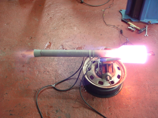

[/url]Hey Guys, got me a new bottle today and tuned the regualtor a bit and now im getting full power out of the engine. Thrust must be between 6 to 8 kg, It was pushing the rim over the floor a bit! And damn, now it IS loud...
Can anyone estimate the frequency of both runs please? I flared the intakes today and added a starting air line.
So, have fun with the vid!

MAG:  Looks Good!  Sound and running like a different animal now!  It looked like your air line may have been effecting the one intake a little.
What is the overall lenght of it?
What are you going to do with it? Use it as a test bed? Practical?

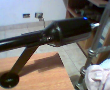

hello to all
this it is my new creation of Sunday
it is a copied thermalpulse of 3lb of eric
it has finished it hardly for 30 minutes, here it is 10pm o'clock
therefore I won't light it today
the truth me to side to weld the entrance,hehehe, but I believe q it won't lose over there ...
some pictures! !
(tomorrow I hope to give him it goes! , (if I don't have a lot of work). . . . )
some pictures! !
