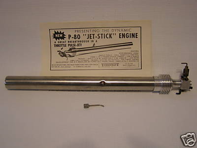

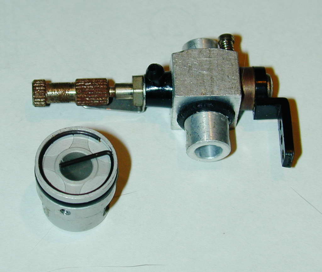

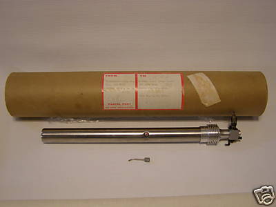

Here's that little engine I saw on eBay if you might know of the valve design.
I recall Tharratt mentioning an engine merrily bubbling along at ~7 pounds of thrust and throttling up to 100 lb instantly. And he had some reeds that lasted 24 hours at full thrust, some runs lasting 6 hours. He also used a dish flame guard and reeds with neoprene layers to soften the impact. I think he also mentioned forward air speed being effectively the same as increasing valve area.
As you have been building pulsejets for many years, have you built any straight Schmidt tube designs? I saw this little hobby engine on eBay and was wondering if you knew what kind of valve it had, if it was an "angled" pyramid design or petal valve like the Dynajet or something else? I just like the cylindrical shape for the simplicity, even though it never became the hobbyist's dream engine.
Have you made any engines with a new kind of valve? To me, inventing something new is the fun stuff.
Thanks,

That is a cool looking engine. If I had seen it on ebay I would have bid on it. I check ebay from time to time. I have not been on ebay all summer. It is hard to tell from the picture but it looks like the tip end of the exhaust is smaller. The Germans learned the combustion pressure has to be no less than 1.2 to 1 for an engine to pulse. They also learned the higher the combustion chamber pressure the more efficient the fuel burns and the more power the engine produces. I assume that is why most hobby engines have a compression ratio of about 3 to 1 so they will produce more power and use less fuel. I have not built a straight tube pulse jet engine a compression ratio of about 1.5 to 1 is as low as I have gone. I have one engine that I put a 2 cycle engine carburetor on the intake of the pulse jet engine. When I open the carburetor throttle the engine throttles up. It works great.

Mark on the valve of the glowstick I have a picture of it somewhere! Which I will try and find for you. Its one very complicated piece of work and Its definately not something we could whip up in the shed... Its sort of like reed valve from a Cox engine (same principle) but much more complicated..

I've a few old Cox engines and a McCoy. When I was about 12, I would fly a model such as this doing loops and having to fly up and over cars as they came down my street, my yard not big enough. hanoclassmac1972 wrote:Mark on the valve of the glowstick I have a picture of it somewhere! Which I will try and find for you. Its one very complicated piece of work and Its definately not something we could whip up in the shed... Its sort of like reed valve from a Cox engine (same principle) but much more complicated..
Robert Bolton
http://www.craftsmanshipmuseum.com/images/Cox10.jpg
I guess you are saying the reed is something like an oil can where when uplifted the fuel and air can skirt in all around the edges, instead of like a petal valve that is pinned down at one edge? The old Cox reeds were a copper-beryllium alloy shaped like an X but now they make them in mylar.
http://www.modelenginenews.org/cardfile ... 1_reed.jpg

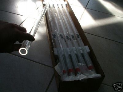

I have an 18 inch plumbing pipe, one inch in diameter that I screwed a bell onto one end, the bell a one inch necking down to a half inch for the intake. And I used a single reed for this engine. I could never get enough compression to get it to start either by spark plugging it with a little 1/4 32 plug or by priming and lighting the tail end with a flame. All I got was a sick duck quacking sound. The only way I got it to start was by corking the tail after misting the insides with methanol and then like a pop gun, spark the cylinder, this gave it enough compression/impulse to sustain. It would run for a good five seconds but then die slowly or just stop, the fueling was just some very small diameter copper tubing cocked upright inside the intake of the bell, very crude. At some point I want to try making another, but I want to use my quartz tubing.
I bought an old Dynafog fogger and it too had a morass of parts for the valved intake.
Thanks for that tidbit Robert and I hope you can find your picture of that engine intake, I am curious what features it has. Funny, the literature says the P-80 Jet-Stick is made of long life "titanium - inconel X stainless steels." Mine will be made of waveguide tubing - flame-fused natural quartz crystals mined in Madagascar. ha
(I asked a branch of Heraeus in Georgia if they knew anything about my tubing I bought on eBay)
"Hello Mark,
We have found some old paperwork which I can with 100% accuracy say
that part#1565 was produced for Nortel and the material is Heralux WG material. That is Flame fused natural
quartz crystals. OH content 130-180ppm, <50ppm Cl This natural base material was taken from mines in Madagascar in Africa."
Another meager tidbit.

I was noticing how perfectly similar this part is to the P-80 Jet-Stick head intake. You know those U-shaped flanges of metal that keep the needle valve from vibrationg to a different setting? It looks like the P-80 picture has one and the disassembled valve part jpg is missing its. But you can tell these parts are both made by the same company. Try blowing up the attachment picture and one can see it seems the P-80 borrows that part from some other company, if not Cox. Still, there may be more tricks to the P-80 but this tidbit is a good start of the puzzle.
I wonder if they made the finned head or if that came off some other engine as well? I wonder where they got the straight tube. ha
It's interesting to keep in mind the dimensions too, 1 3/8" X 14", I suppose the actual length to diameter ratio of the duct by itself is less. Might the head be 3 inches long or what? That would be a L/D ratio of 8 to 1 if the duct is 11 inches long. No telling how much of the finned head is hollow or adds on to the ratio.
"The reed design and its retention spring are again, distinctly Cox (of the "old" pattern). The R/C throttle plugs into the center of this assembly with yet another "O" ring and two cross-point screws. The throttle is quite conventional, being of the "non-compensating" type. It has a fixed air bleed hole and a screw sets the idle limit. Fuel inlet is provided by a neat nylon banjo. Not so neat is the throttle arm. As moulded, this would have interfered with the crankcase, so the tip has been circumcised with side-cutters. This, and the prop nut, are totally out of character with the quality exhibited by rest of the engine, but completely original."

P-80 (as I make it out)
Overall length: 14.125" (incl. mixture or idle? screw)
Overall Width: 2.5" (incl. needle valve and control arm)
Tail tube: 1" OD, no taper, 11" showing
Head: tail socket 1.25" OD, 0.5" long; fins 1.375" OD, 0.625" long; fwd taper section .125" long
Inlet tube: 0.625" OD, 0.625 long (taper to throttle body)
Carb: 0.75 long (incl. throttle body and fwd. end of venturi)
...more or less...
(The advertised overall dimensions (14" x 1.375" agree with the main components minus the needle valve, control arm and mixture or idle stop screw.)

As you've learned, the P-80 purports to be a "fully throttleable true jet engine" and was one of many p-j designs to come out of N. Carolina. Don Laird got some info on the man responsible but I can't recall his name.
The reed valve was circular and made from .005 in. thick brass or bronze, with zig-zag members extending from the outer rim to the center disc (about 1/2 in. diameter,) that was trapped in place by the inserted head assembly. It was so very sophisticated that I decided it was mfd. for another application and usurped by the P-80 mfr. The bottom line is that, insofar as I've been able to learn, none of the products of that company ever delivered what was claimed, some of them (such as the P-80,) not functioning at all!
I have another product from them, purporting to be a pulse-jet but appearing to be a questionable pressure jet. Made from material similar to the P-80, it has two main parts; the front is a pressurized tank (filled with acetylene or similar fuel,) and several nozzles that feed the fuel through ports into the rear pipe. In mine, the adjustable needle valve is so poor that it couldn't retain a few ounces of pressure, much less the hundreds of pounds from acetylene.
Anyone trying to operate any product from this company would be well advised to be careful and not get his hopes very high.
