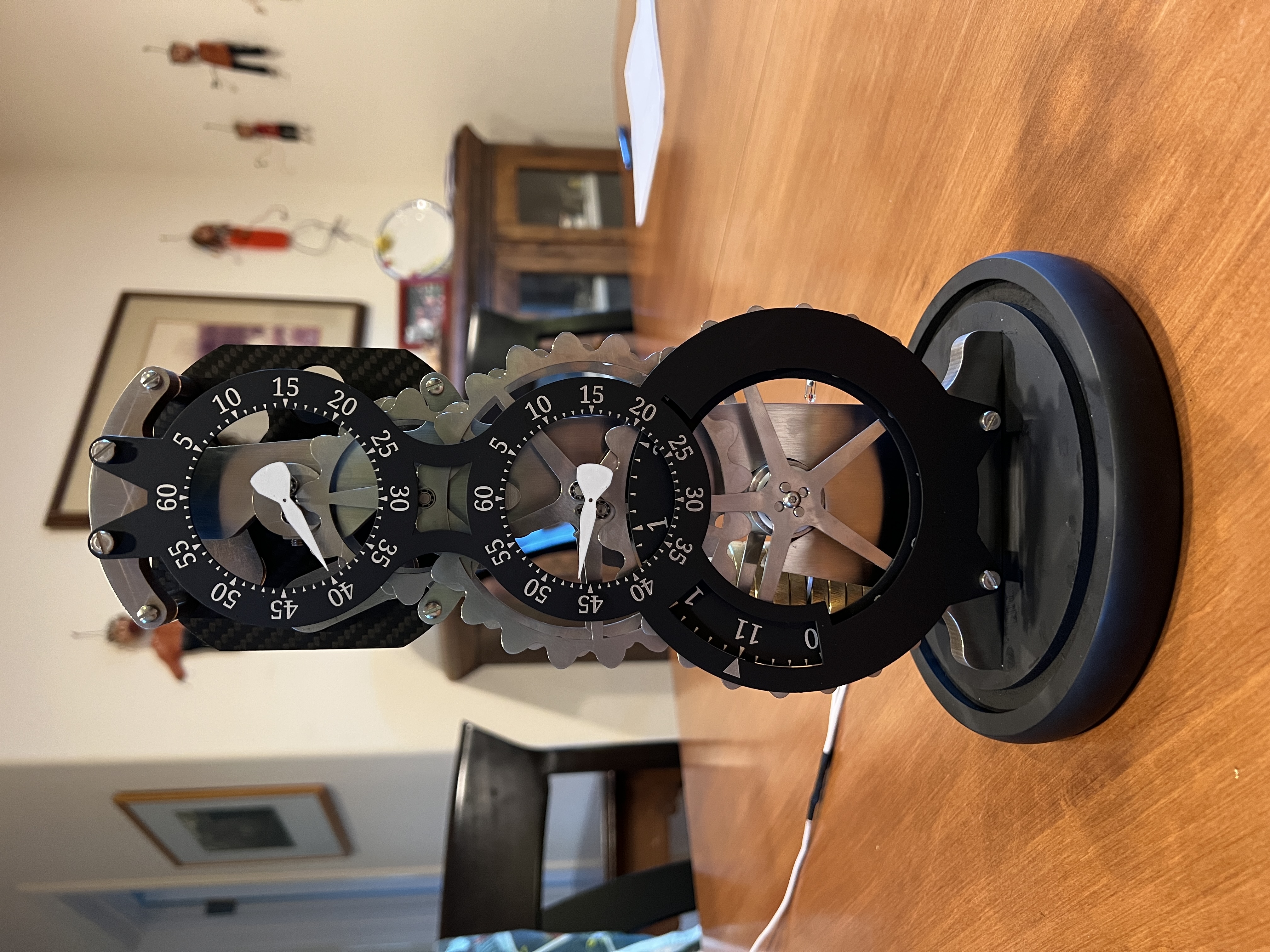

Here's what I've been working on lately, non-resonant timekeepers.
And here's a paper I've written about it, some light bathroom reading!

Mike, that's a super interesting read, and already a very cool clock.

About time someone posted something here again! See what I did there?....I'll let myself out. Nice clock Mike!

Mike that's a lot of research and "time" you've put into the project. Interesting history and methodologies. The magnetic induction brought to mind a viscous fluid resistance effect.

Ha, Mark, spot on. The next one is a viscous shear type, and the deep dive has been how to compensate for viscosity change with temperature, and using liquids available three centuries ago, like ethanol. That approach has a chance of doability in the 1700's.
