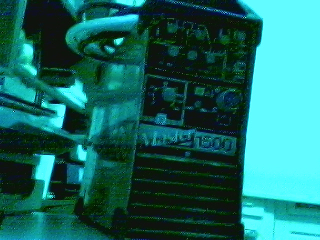

Viv,
go for a tig-welder if you want to weld thin stainless steel. I bought one two month's ago on a second hand internet-marked place. Some people don't know what they are selling so for me it was a bargain. I admit I am happy with it. :-)
Here's a picture.
Pieter.
Here's a picture.
Pieter.
- Picture 23.jpg (226.28 KiB) Viewed 17486 times
