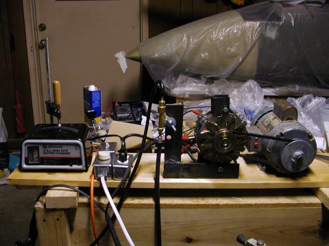

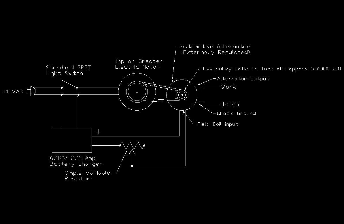

Here is a basic schematic for my homemade TIG welder. It's really this simple. I have been amazed at how well it works. I can make much better welds with it than with my MIG welder that I bought.
For the electric motor I used a 1 hp motor from an old table saw. It works ok for welding small stuff but will stall if I turn the current up too much. The alternator I bought new for $30 from an alternator repair shop. It is a 90 amp Chrysler unit. I've heard that Chryslers are usually externally regulated which means that they do not have a built in voltage regulator. You don't want a built in voltage regulator since you want to manually control the voltage to the field in order to adjust the output to the torch. I used a regular battery charger from Wal-Mart for the field coil power supply. It has a 6V setting as well as a 12V/2 amp and 12V/6 amp settings. For most of the work I've been doing with thin stainless I use the 6V setting. For thicker (1/8" is as thick as I've tried) I use the higher settings. When I first built this welder I used a stainless steel wire wrapped around a board for my variable resistor. I called it my Wire Wrapped Around a Board Current Regulating Device or W.A.B.C.R.D. (pronounced wabcrud) for short. It worked great but it was a bit of a pain to adjust while welding. I've since developed a more sophisticated WABCRD that includes a homemade foot pedal control. I'm still perfecting this but so far it works great. I'm in the process of obtaining components to build a high frequency unit like Al Belli's. I also have ideas for building an electronic device to re-invert the alternator output for AC.

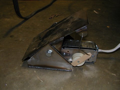

- Foot pedal control
- Pedal.jpg (27.61 KiB) Viewed 68879 times
- My early setup
- welder.jpg (40.9 KiB) Viewed 68916 times

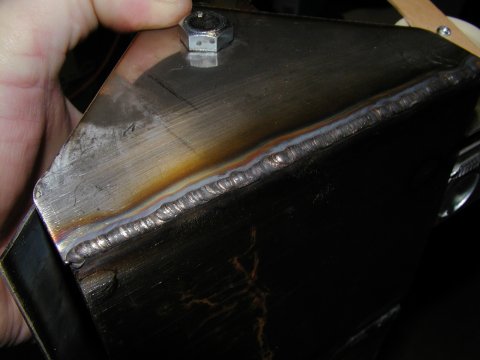

- Weld made with homemade TIG
- weld.jpg (23.86 KiB) Viewed 68878 times
- Basic TIG welder schematic

I don't know about the TV flyback transformer. I don't know enough about HV/HF. I'm just going to build the same circuit that's in Al's schematic. I ordered the parts yesterday. I wouldn't be surprised if there was a cheaper transformer that would work. I guess you would just have to tune the rest of the circuit to match.
About re-inverting the DC into AC. Please correct me if I'm wrong since I'm not a EE or anything, I just have a rough understanding of a few basics. The alternator is 3-phase so how do you hook up a 3 phase power supply to something like a welding torch and the work. Any one phase is only 1/3 the output power but if you combine all 3 phases they sum to 0, not the full output power of the alternator. To weld you need single phase AC. The only way I see to do this is to invert it after it goes through the rectifier. Is there another way? Like I said, I don't know all that much about this. I could try to use only one of the phases but than I'm limited to only 1/3 the output of the alternator. I tried it once and it wouldn't sustain an arc. After I had finished and rewired the rectifier, I realized that I had my battery charger set to only 6V which works fine for DC welding on thin metal but maybe it's just not enough when only using one of the AC phases. Also, I was kind of worried about running a bunch of current through 1 phase while the others weren't doing anything. I was afraid this might damage the alternator somehow.

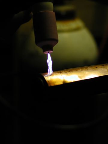

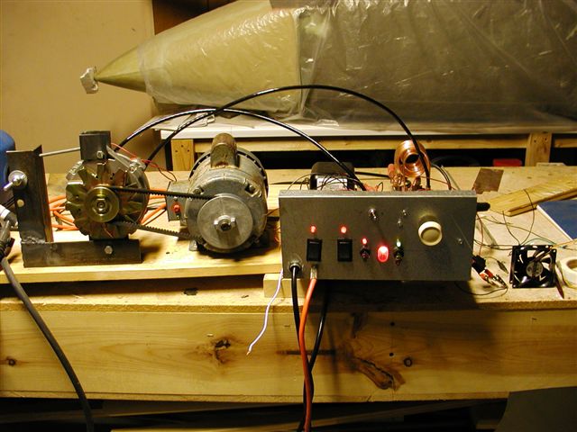

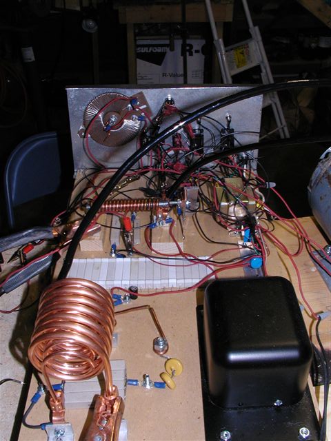

Just an update on my welder project.
After building my HF unit I decided to build a few more electronic gizmos for my welder. I wanted a start or continuous function for my HF and I wanted some nice switches to make everything easy to deal with. I also wanted a better way to regulate the field current and I wanted the whole thing in one package instead of a bunch of wires running all over my workbench. I'm in the process of completing it but it's come a long way. On the photos you'll see the control unit on the right that includes the HF unit along with a bunch of other stuff. This project has been severly afflicted with "creeping featurism". It now includes (from left to right) a master power switch, a motor switch, a hi/off/low switch for the field, an "easy start" feature, a start/off/continuous switch for the HF, and a continuously variable current regulator. Also included are a foot pedal control and a rudimentary pulse feature. Everything seems to work pretty well at this point except the pulse feature. I just wired it tonight and I haven't gotten the bugs worked out of it yet. The next step will be to build a more user friendly switch layout and house the entire thing in one portable container.
