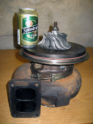

Picked up a pair of Schwitzer S500:s today.

That is a large turbo!

Hi Anders
Nice "little" fellow
Shaft or thrust ??

They are quite large, 80mm comp inducer and 90mm turbine exducer. One of the two turbos looks like new but the other one has damaged turbine inducer tips so it will be used as a spare.
This project will be sort of a joined effort, I got the turbos for a friend but I will have free hands to design the engine as I see fit. (almost at least, he is very stubborn about having a four-stroke engine driving the oil pump while I insist on a 12V drive to save weight) I will assist him as much as I can during the build and post any major progress here.
It will fit inside a kick frame and be run on the ice this winter like my Thunderchine kick, so no power turbines this year unfortunately.
