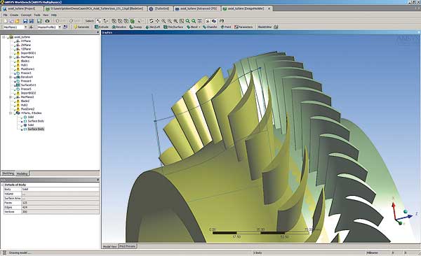

Post by saugumas » Thu Jul 12, 2007 9:22 pm
I use ANSYS it has wide range of modeling, meshing, solving tools.
ANSYS even have add-on special for turbine design- BladeModeler for design and TurboGrid for meshing.
take a look at this great software brochure:
http://www.ansys.com/assets/brochures/b ... ler-10.pdf
http://www.ansys.com/assets/brochures/turbogrid-10.pdf
I have done some airfoil design testings at high speeds(Mach 2+), now I am learning blade designing.
Regards,
Kestas

Hello,
COSMOSFloWorks is great for simple design testings as it has wizards and intuitive interface, I even didn't read help for first sim:) But it lacks functionality for real-world turbojet engine design testings. Also ANSYS can interlink several analysis on same model, SolidWorks COSMOS* is not capable doing that. Also, it is very important for gas turbine design testing, ANSYS is capable simulating combustion.
ANSYS is harder to learn, but easy to use. ANSYS has very good documentation.
Many modern jet fighters(F-16(recent modifications), Joint Strike F-35, etc), airliners(airbus a380) and *jet engines have been tested on ANSYS before real-life testings.
ANSYS is also compatible to modern supercomputers, mainframe computers and computer clusters.
http://www.ansys.com/industries/documen ... -spr06.pdf
Image Image

What formats ProE is capable saving/exporting ? As far as I know ANSYS is capable importing from ProE.
Now I am designing KJ66 turbine on CAD too, if you share your great work, we can save time and do simulations and design improvements together.
I am using UGS NX 5 & ANSYS BladeModeler for design and ANSYS 11 for simulations.
