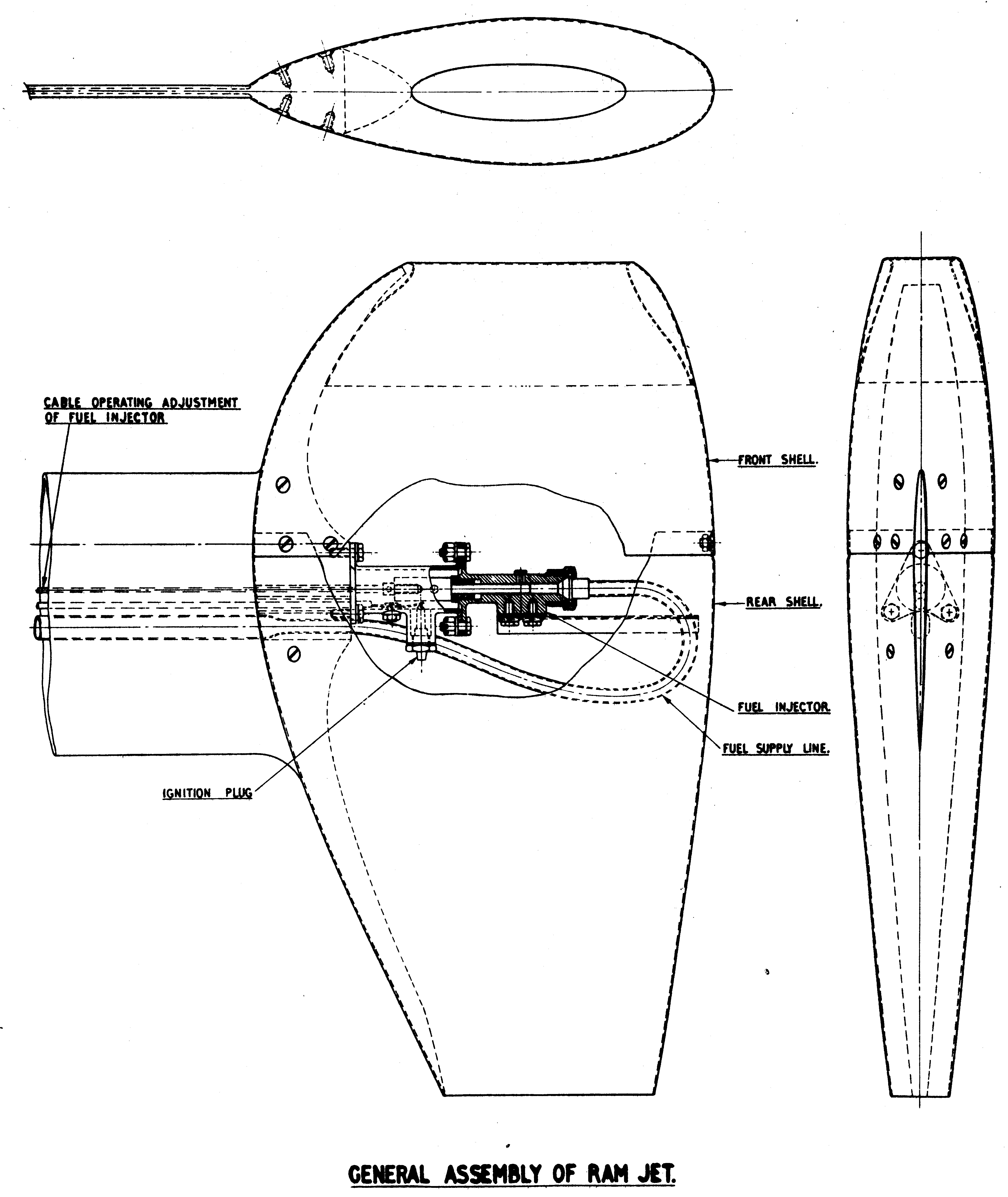

Also in this design of a HR144 T helicopter (see pic) they inject very late and also the flameholder is very late. Why that???
Why wouldn't one do the flameholder right after the diffusor or already in the diffusor like in the Hiller Ramjets (which I again do not understand anymore, why one would advance the flameholder that much)?
OTOH I anyway think the HR144T ramjet violates basically all design rules from the Decker manual...(e.g. the inlet area is equal to the outlet area)
