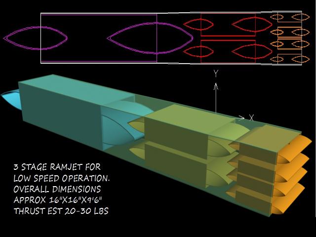

Post by makulit » Wed Aug 03, 2011 4:26 am
Here's what I was thinking 20-30 lbs thrust at 50 MPH

Post by metiz » Wed Aug 03, 2011 9:19 am
Makuilt, will there be fuel injected at each stage? if so, you're going to have an oxigen and temperature problem.

Post by Pscott » Thu Aug 04, 2011 12:37 am
Just a couple of notes on your design.. Looking at the mass continuity accross the engine and some rough mathematics, it seems you only need an exit velocity of 29 m/s (65mph) in order produce 30lbs of thrust, this is based on gross thrust and neglecting engine drag. In fact assuming ideal conditions and a conventional subsonic ramjet design, the actual exit velocity of an engine with your dimensions from thermodynamic equations is probably in the region of 150 m/s. But will be far less in real life due to the poor combustion efficiencies from the low pressure recovery generated at low airspeeds.
The centrebodies will actually reduce performance at these very low Mach numbers due to the increase in drag and a reduced intake area, which will in turn reduce air mass flow and so reduce thrust. The hot exhaust from the stage in front will also drastically reduce the pressure recovery of the intake operating in it. My latest projet will see me testing the performance of a micro ramjet in the high speed exhaust of a small gas turbine engine. The high ambient freestream temperatures and the the effects of the combustion products on the gas properties both effect the engines performance. In fact running the simulation for ISA freestream consitions gives an increase in thrust of more than 400% compared to the engine in the jet exhaust where the freestream temperature is 400`C.

Post by makulit » Thu Aug 04, 2011 3:44 am
For thrust, I'm using Decker's chart from practical ramjet design, extrapolating for the lower speeds. If the thrust is actually better, awesome. If I can cut out a stage, another awesome. Regarding the centerbodies and drag: The bodies are streamlined, the airspeeds are slow, and unless I missed something the intake area has to be between 1/3 and 1/4 the combustion / heating cross section area anyway, so theres not much getting around either a necked opening or a centerbody. The centerbody will let me move the actual object around a lot without major rework, so I can fine tune the locations. (planning to bolt them in) Thinking more about the rough math you mention, I'd like to see what equations you're using. (Did you use a mass/energy flux analysis?) Also when you say 65 mph gives a 30 lb thrust, what do you mean? a 65 mph increase in velocity? What area is this thrust applied to? (or what volume is assumed?) Thanks.
Oh, and I looked at the linked page - very nice explanation of what you're doing. I especially like the background image. I would love to see that ramjet used on the P-61 up close and personal and know how much thrust it produced at what speeds. I understand what you mean about the problem of the intake being in the hot exhaust, and my plan was to let the cooler bypass air be grabbed by the hotter faster exhaust air, slowing it a bit, cooling it a bit, but significantly increasing thrust (at least based on what I read about thrust augmenters). Really I want to get building and start getting numbers. Measuring velocity and temperature will be interesting. I haven't planned that out yet.
Oh, it might not be obvious, but the open area is pretty much the same at each inlet stage.

Post by Pscott » Thu Aug 04, 2011 11:06 am
The 65mph quoted would be your total exhaust veleocity, therefore only a small increase over freestream speed.. Personally I'd remove the centrebodies and reduce the engine diameter, this will reduce drag and still give you the same cross sectional intake area.
The way I approach these things is to start simple by assuming the engine is operating under an 'ideal cycle', this means that no heat is lost, (aqdiabatic) and any compression and expansion is isentropic and fully reversable. Then it just a simple case of appling perfect gas laws at each stage, and using a few assumptions, (like the combustion temp), you can get an idea of the engines performance.
When the engine is operating under steady state conditions, (constant throttle posistion, steady airspeed ect), and with good estimates of each components efficencies then its not that inaccurate. I wrote two programs to simulate the steady state and transient performace of small gas turbines, and the steady state model was within about 5% of the experimental results for the temperatures, thrust, fuel flow, mass flow ect.. The transient model was less accurate, when compared to the engines actual performance during say a minimum to maximum throttling. This is mostly due to the heat transfer occuring in the engine as it moves from one steady state condition to another, which I'd neglected in the model at the time.

Post by makulit » Fri Aug 05, 2011 2:02 am
Thanks for your comments. I will probably keep the center bodies during development because it simplifies construction (remember I'm building engines whose dimensions are constant in one dimension) because I can tweek the positions easily. I don't know if everyone already knows this but if you wanted to make fine adjustments on a thing thats bolted or screwed together there's a neat way to do it that's like reading a vernier. So we will have a series of holes right? but the holes are 1 cm apart, hardly fine adjustment on a small model right? well if I have 10 holes on one side, and 11 on the other where the 11 first and last are the same distance as the 10 first and last, I can make 1 mm (rather than 1 cm) adjustments. You've triggered my "Have to find out" mode and I will have to look at the difference in drag between the two designs (with and without center bodies) I should be able to compare them based on the drag coefficient and the area. This weekend I hope to be able to build something for some testing. Hot Jets!
http://www.grc.nasa.gov/WWW/K-12/airplane/foil3.html
This fun little applet lets one compare drag and various shapes. When I compare flat plates on an angle (an inlet without centerbodies) to a symmetrical airfoil, I get that the drag on the flat plates (10° Angle) would be about 10 x the drag on the centerbody. If that's anywhere close, it should show up in the tests. I'll take pictures. I'm planning to set the models up like ballistic pendulums and use a leaf blower for airflow.

Post by makulit » Sat Aug 06, 2011 5:31 pm
Update: I revised my assumptions regarding the flat plat at 10° for the no centerbody design and used airfoil sections instead and was able to get the no centerbody drag to be about the same as the drag on the centerbody. Meanwhile I have stumbled upon a treasure trove of NACA documentation and I intend to download it. I'll mirror the data and post links to the original and mirror later.
