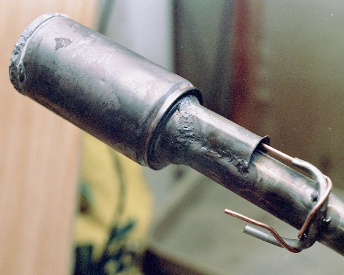

				- The finished weld between the pipe assembly and the chamber - yes, I had to patch a few holes. I also added the air/fuel pipe assembly for this shot. Photo Copyright 2005 Larry Cottrill
- FMCII_chamber_intake_welded_crop1_small.jpg (169.5 KiB) Viewed 16051 times

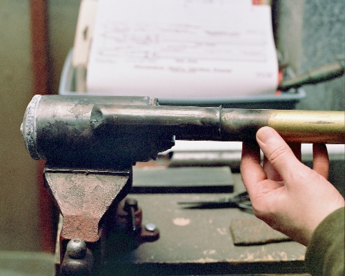

				- This 'top view' shot attempts to show how far the intake assembly will penetrate into the chamber. Photo Copyright 2005 Larry Cottrill
- FMCII_chamber_intake_depth_crop1_small.jpg (171.81 KiB) Viewed 16053 times

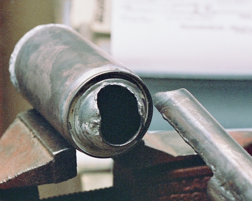

				- The rear of the chamber slotted out for the intake assembly - done by melting the edge back with a small flame. Photo Copyright 2005 Larry Cottrill
- FMCII_chamber_slotted_crop1_small.jpg (165.63 KiB) Viewed 16054 times

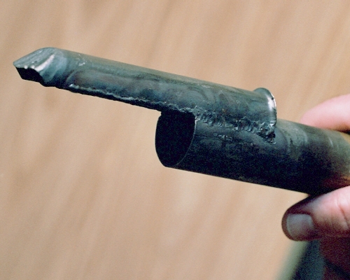

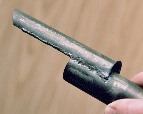

				- Front and side view of the finished intake/tailpipe assembly. The downturned lip is formed entirely by heating and hammering. Photo Copyright 2005 Larry Cottrill
- FMCII_intake_finished_front_crop1_small.jpg (144.17 KiB) Viewed 16057 times

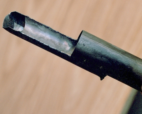

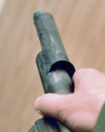

				- Side view of the weld joining the intake half-shell to the notched tailpipe front end, before shaping the front end of the spout lip. Photo Copyright 2005 Larry Cottrill
- FMCII_intake_welded_side_crop1_small.jpg (148.61 KiB) Viewed 16052 times

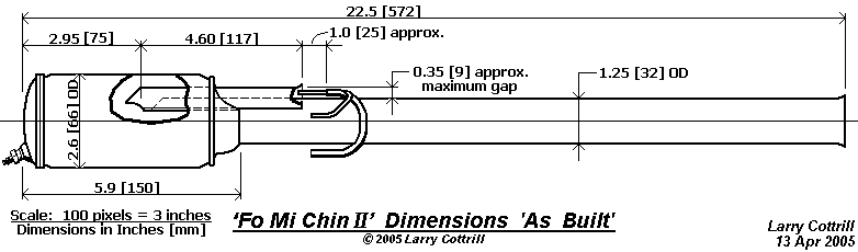

Here's a simple scale drawing showing the final dimensions for the new, improved Fo Mi Chin II. Note that I can't really measure such an object to the nearest .01 inch, but these should come pretty close to the truth. I included the extra 1 inch [approx.] that I ended up with. It was hard to get very accurate positioning of the intake spout because of working with the hulk of the old Fo Mi Chin, but everything should be close enough for it to start and run.
Hope you like it, Bruno, and that it kicks right off and runs for you!
				- Scale drawing of finished Fo Mi Chin II, showing the actual "as built" final dimensions. Drawing Copyright 2005 Larry Cottrill
- Fo_Mi_Chin_Ver_II_scale.gif (5.93 KiB) Viewed 16050 times
