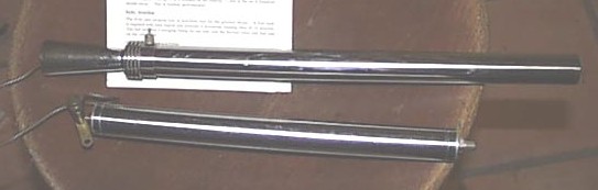

Good photo, we now see the plug penetrates the aluminum(?) collar. It makes me wonder if it is aluminum because that has to be a hot area, however, probably the stainless tube is fit inside, and heat transfer is slow enough not to exceed the aluminum's yield point. Also we see the backside of the carb not sure what the dark ring to the right is.
It sure would be great if we could get a shot of the valves from this owner.
You say check out his pictures -- are there others than that one?
EDIT: okay, tracked it down, here it is:
http://stunthanger.com/smf/index.php?to ... .msg127832
Mark?
Check out that valve!
They said RCM reviewed it and panned it because they couldn't start it (reminds me of my own engines). Apparently they tried white gas and when it was finally flooded and leaking out the tailpipe, had a fire.
Some puzzlers:
1.) The spark plug location in the box illustration is different than the one on the physical engine in the above url, and different than the one pictured earlier. One has the plug in the aluminum head collar, the other far down the tailpipe.
2.) A glowplug is shown, not a spark plug, and has the coil expanded and pulled outwards. If a glow plug was used, wouldn't the appropriate fuel be methanol instead of white gas? Was RCM using the wrong fuel?
3.) Are there two different versions of these engines -- one with a spark plug, and one with a glow plug, designed to use different fuels?
4.) I'd love to see webpilot analyze that valve!

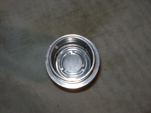

After reading Jerry's description of this valve which has a 9/16 inch petal reed/disk suspended in the center of the maze-like spider spokes, I was wondering if anyone had a name for this type of valve or what company might make it? It's funny, it's almost an optical illusion the way the maze at first just looks like a bunch of zigzag curved segments with nothing in the center.
What other use might this reed have had other than in the P-80 Jet-Stick? Something very delicate I suppose. ha
Might it too have been used on some make of piston engine to regulate air and/or fuel flow, as other parts of the head of the P-80 seem to be Frankensteined from model engine parts? Could it be a Kavan part?
