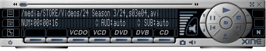

This program used to complain about not finding my sound card. I read quite a bit about possible remedies, but the few I tried did not make it work. It now works.
The glitch is fixed but not by me; it's possibly due to one of my recent installs of upgrades.

Xine is working now, too. Some video players have troubles 'syncing' audio with video in some .avi files. I just keep choosing until I find one that 'syncs'.

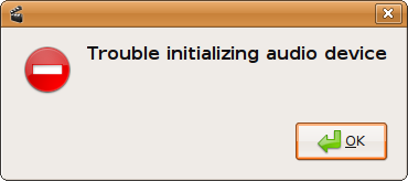

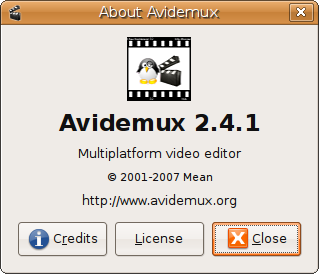

Avidemux gives me this error message,
I can still edit, save and then play the cropped video with audio. I just can't hear it while I am editing the file. I think some other program is not "releasing" the audio device when finished.

Try Avidemux Tools>Preferences>Audio>Audio Output>OSS
Works for me in Puppy, even though ALSA is supposedly my standard audio device. Or try some of the other audio device choices in that pulldown list.

I had to use Avidemux Edit>Preferences>Audio>Audio Output.
It was already OSS, so I tried ALSA. Nope. I tried SDL. Yes, that works for now, but audio is scratchy and video is jumpy.
