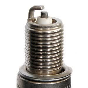

 Second, I pulled the right sparking plug. Even in the evening outdoor light I could see the white porcelain was blackened. I cleaned most of the tip surround with a wire brush and the electrode gap with some sand paper. I put it back in and the bike ran pretty well after it warmed up.
 The back firing ceased, but I have a "stumbling or break-up (rich)" region around 2500 - 3000 rpm. From there it seemed to "pull" quite well. I rode it all around that night while "bar hopping" without any incident.

 Sunday, I did take her out. I added gas from the pump to the tank. A couple of hours later, she did start to miss, backfire and break up a bit. I pulled into a friend's house and removed the right plug. I found it sooty black, indicating a RICH condition. I cleaned it.
 Before putting it back in, I checked the left plug. I found it not as bad, but still sooty black. I decided to swap cyls with these plugs. I rode her all the way home, without a miss.

 Returning home, I cleaned both plugs with a sand blaster. The former "right" plug won't fire anymore, so it's junk. I carry the former "left" one around with me as a spare.

 I had two new plugs, so I used them. They are Champions, but I had to special order them from the local Advance auto parts store last summer. I got on the phone and ordered 6 more.I picked them up the next day.
Item Name:
 N7YC CHAMPION PLUG
Item #:
 813
Price/ea:
 $2.19
